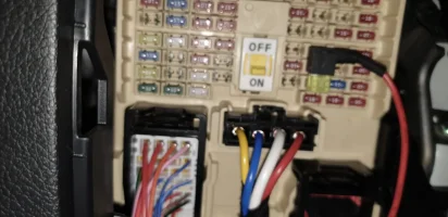

I'm also wondering what this on/off switch is about.
That switches everything off at that panel. Try it ;)
That red wire is called a fuse tap. They all look the same with two fuses on the end. One is the original fuse and the second fuse protects the device you're stealing 12v for. In your case it's the bimodal ECU and muffler valves. If you install a dashcam, it should be wired in the same way, just on a different fuse location.
You can't put a manual switch on that fuse tap though because that simply turns the whole bimodal system on and off and not the valves directly (unless you want it that way).
If you want to control the valves directly with an on/off switch then you'll have to bypass the ECU by tracing the power wires from the mufflers (they'll go into the bimodal ECU) and configure a momentary two way switch between the fuse tap and valve motors. It's fairly easy to do. There's a few videos on YouTube of people doing the same with their varex mufflers.

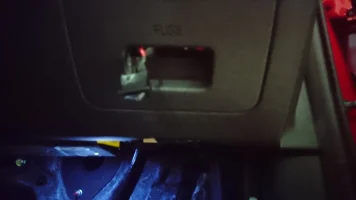

Thanks @basysmith, I finally got the chance to test it out and it actually works pretty well. I will definitely need to install a switch as the exhaust can get loud and I don't want it loud all the time. It also defeats the purpose of having a Bimodal exhaust system.
On another note, any elegant way of installing the switch? I need some inspiration lol. I could just leave the fuse tap in place and insert a switch between the fuse tap and the socket of the red fuse tap cable.
