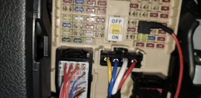

Interesting, so which fuse do I need to pull to keep the Bimodal exhaust open the entire time? Do you know the exact location, maybe a photo with the fuse highlighted would be helpful for some of us who are keen :thumbup:
I wouldn't trust it to be in the exact same spot for everyone because it's a fuse tap and will depend on things like existing taps for dashcam etc and where the installer decided to put it. Like I said, open the fuse panel under the steering wheel and look for a red fuse tap. If there's more than one then trace the power cable back to the ECU box near the accelerator, tucked up under the dash. If you don't know what a fuse tap is then you should probably take it to someone who does incase you go pulling at things you're not suppose to.
Sorry, I quickly read your post on my mobile when I was still at work. Now that I have taken a proper read, I get what you mean now, initially I thought you meant you just had to pull the fuse for the Bimodal exhaust (I totally missed the "tap" part).
I will give it a try sometime tomorrow and see how it goes.

Would the thick red single wire be the fuse tap?
