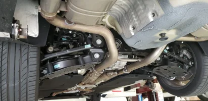

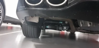

Is anyone able to post a photo looking at the rear of a stinger fitted with Kia's bi-modal exhaust at the exhaust pipe level?
Think I read that when the dealer fits the new exhaust the diffuser at the back doesn't go back on, just wondering if someone can verify?
There are at least two videos showing it, on multiple vehicles, on the first page of this thread - it does not change the rear of the vehicle in any way.
The visible outlets on the stinger are decorative only. the exhausts - stock or aftermarket - simply feed into those.
Here

Thanks for the feedback guys, much appreciated
