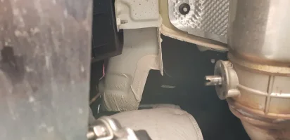

Started it up in the morning to go on the NSW drive and sound was normal except for a metallic rattle. I didn't think too much of it as car was performing normally except for that annoying rattle which came and went. At one of the drive stops I investigated further and found the left side electronic actuator that attaches to the flap shaft had parted company.
This what it looked like when first spotted
Went to Dealer this morning and they immediately put it on a hoist and unplugged the actuator. The flap shaft is clearly shown and has free movement so that was the "rattle" I was hearing.

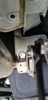

Here's a pic of the right hand side. There's a retaining pin in the centre of the bracket that apparently holds thing together. There are a few possibilities of what happened to the left hand one.... a. It wasn't installed correctly b. it wasn't installed c. it broke....Dealer hadn't heard of this happening previously so there's no proper explanation.
