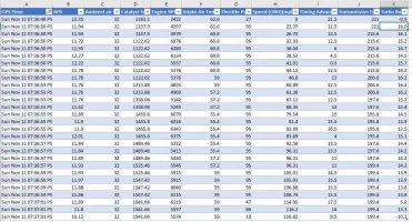

Here are the logs for my Tork Tune 12.02 1/4 mile run. (sorry xls or csv upload not working so just a pic) Tork has more secret sauce than just this so I don't think he will mind.
The readers digest version is 12 AFR, 16 lbs boost and typically 14-16 degrees timing advance all at WOT.
Seems like crazy mild boost to me for a 12.02. I think most piggy backs run 20 or more PSI on their (edit) track maps. This is a 92 octane map.
