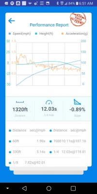

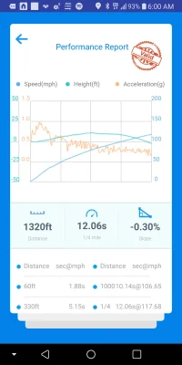

More tuning food for thought. Made a few more runs over the weekend. Not bad for no wmi, no e30, and all 4 cats intact. More tune revisions to come to drop those pesky few hundredths off the 1/4 mile time. Also had a 1.87 60 foot on one run.
Tork ecu, jt intake, fmic, catback

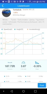

My 0-60 was 3.72 on OBD Fusion, and 4.24 switching to dragy back when using my first Tork beta 1.5 tune. (Later 1.5 beta tune revisions got me to 3.89 and 3.87 on dragy - this extra .37 drop is the Tork secret sauce.)
I only used OBD Fusion once at the track. Distracted myself and ran in comfort mode 13.35 and not finding my notes but pretty sure the app said 12.9s, as i recall it was off by .4
I don't run OBD Fusion for 1/4 miles now as i am usually logging with torque app and running dragy during the runs, but suspect it would read in the 11.6s

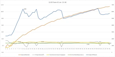

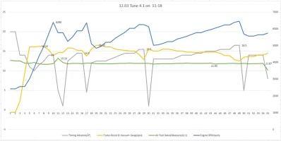

Here are my latest logs from my Tork Tune, 12.03 dragy 1/4 mile. Much easier to digest in chart form.
First is without speed so you can see afr, boost, timing better and the second with speed.
View attachment 15483 View attachment 15484
Wow those look amazing. That low of boost is crazy for the power. And not 1 single visible knock event!
