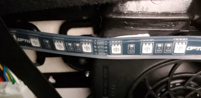

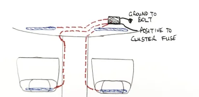

Placed LEDs where I wanted them to be located and ran wires back to power box included in the kit.

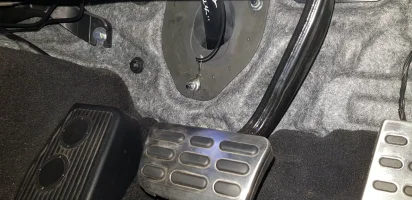

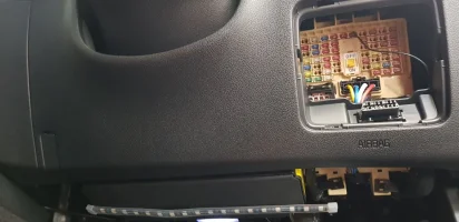

For power i connected the positive wire to the cluster fuse. Negative wire was connected to bolt behind fam pedal.

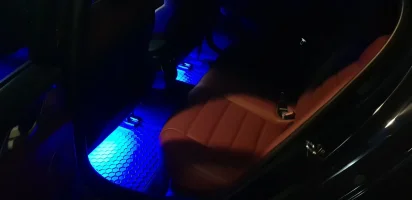

That's pretty much it. LEDs will turn on when you press the push to start button.

The front seats each have 2 elastic straps securing the carpet lining that wraps under the back of the seat and the rear LED strips tucked under this elastic neatly, I just used an inch of double sided tape to stop the middle section of the light strip from sagging. The front LEDs stick directly under the dash using the double sided 3M film already on the back of the strip.

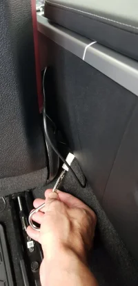

The wiring from the rear LEDs can be tucked under the plastic trim that runs down each side of the centre console (you will just need to move the seat to get access as you conceal the cable) and both left side LEDs wiring can be fed under the dash and over the transmission tunnel to the the lighting control box that I tucked up inside the dash behind the steering wheel. Where the control box positive power wire runs to the fuse box you will need to pull apart and separate the ground wire here so it can reach down to be secured to the bolt behind the brake pedal.

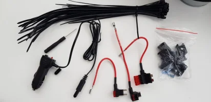

Anyone have any tips to getting a good connection through the fuse into the module? If I run it through the fuse it doesn't work but using the cigarette adapter works. I'm guessing i'm not getting a good connection in there. This is my first attempt at powering anything in my car through the fuse so I could just not understand fundamentally how it works. Am I to wrap the exposed wire around a single fuse leg or both? Should I somehow wedge it so it gets pushed in with the fuse? Any tips would be helpful, thanks!
https://www.amazon.com/VIOFO-Circui...ocphy=9010937&hvtargid=pla-586493323860&psc=1
