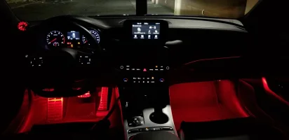

    I added interior under glow LEDs front and back seats. I connected them to the cluster fuse located on the fuse box under the steering wheel. Then just find a ground.
    The leds will turn on when you press the push to start button which activates the cluster this way.

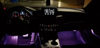

  6. Jays_stinger
    Jays_stinger United States Member
    76
    50
    Location:
    Anaheim, CA
    This is driver and passenger area.

  10. Jays_stinger
    76
    50
    Location:
    Anaheim, CA
    The fuse adapters they give didint fit. I tapped into the cluster fuse. Wrapped positive wire around the fuse and put it back in its slot

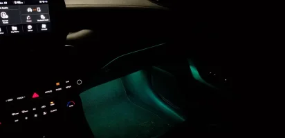

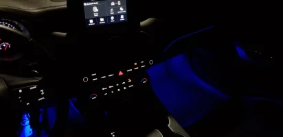

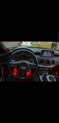

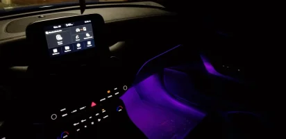

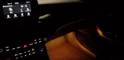

  12. Jays_stinger
    76
    50
    Location:
    Anaheim, CA
    Here you go. I took pics with every ambient light available. The kit I have matches them very well.
    • Like Like x 2
    • Winner Winner x 1
  13. Jays_stinger
    76
    50
    Location:
    Anaheim, CA
    I just added some.

    Wow. Super nice! How’d you do it? Thank you for this post!
  16. Jays_stinger
    76
    50
    Location:
    Anaheim, CA
    Purchased the LED kit from Opt7. Link is above.
    Placed LEDs where I wanted them to be located and ran wires back to power box included in the kit.
    For power i connected the positive wire to the cluster fuse. Negative wire was connected to bolt behind fam pedal.
    That's pretty much it. LEDs will turn on when you press the push to start button.

  20. Kamauxx
    3,889
    1,486
    How bright do you have it set in the pics?
