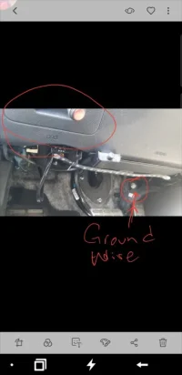

Where did you ground it?
Edit: nevermind. Found a painful spot.
Right here. It's an easy spot to get to. Right on top of the gas pedal. Place it in between the bolt and washer.
Ha, yea that would have been easy. I figured it wouldn't work because of the plastic. I found a bolt next to the fuse box that works.
