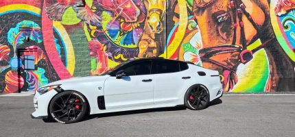

20x9 +33 and 20x10.5 +40 lowered on Eibachs for a few more weeks until BC Racing coilovers show up. Yes, the wheels are two different designs. But the car doesn't know any different. Same offset, same weight, you just don't see both sides of the car at the same time so why not...stinger 2.webpstinger 1.webp

20x9 +33 and 20x10.5 +40 lowered on Eibachs for a few more weeks until BC Racing coilovers show up. Yes, the wheels are two different designs. But the car doesn't know any different. Same offset, same weight, you just don't see both sides of the car at the same time so why not...View attachment 85196View attachment 85195
ha nice setup

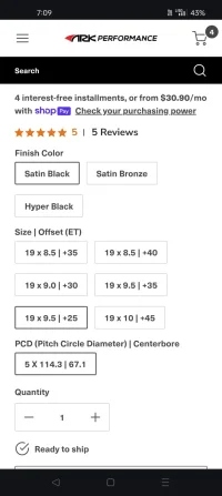

I'm looking to swap my wheels with AB-52 from ARK. Anyone know what offset and width to pick? I was thinking 19x9+30 front and 19x10+45 rear. They also have other sizes in the picture.

Cool.
Sizes?
Front: 19x8.5 / 5x114.3 / +30mm / CB76.10
Rear: 19x8.5 / 5x114.3 / +40mm / CB76.10

Yes, that would work just fine. The whole point of doing a square setup is so you can rotate the wheels front to back, so you need the same offset front and rear.

Check out our customer @thisguystinger who just shared installed photos of the newly released Avant Garde M570R in 20x9/10.5!
