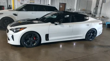

Hi all, wanted to share my winter wheel setup. I got my 2018 GT Limited back in Feb of this year. Loving it so far!
Superspeed RF03RR - BLK
18x8.5+35 (front)
18x9.5+38 (rear)
Michelin X-Ice III Snow
225/45/18 (front)
255/40/18 (rear)IMG_4073.jpeg
That is very attractive, and for winter no less.
Lol, your bumper sticker. Is that to appease a spouse?
