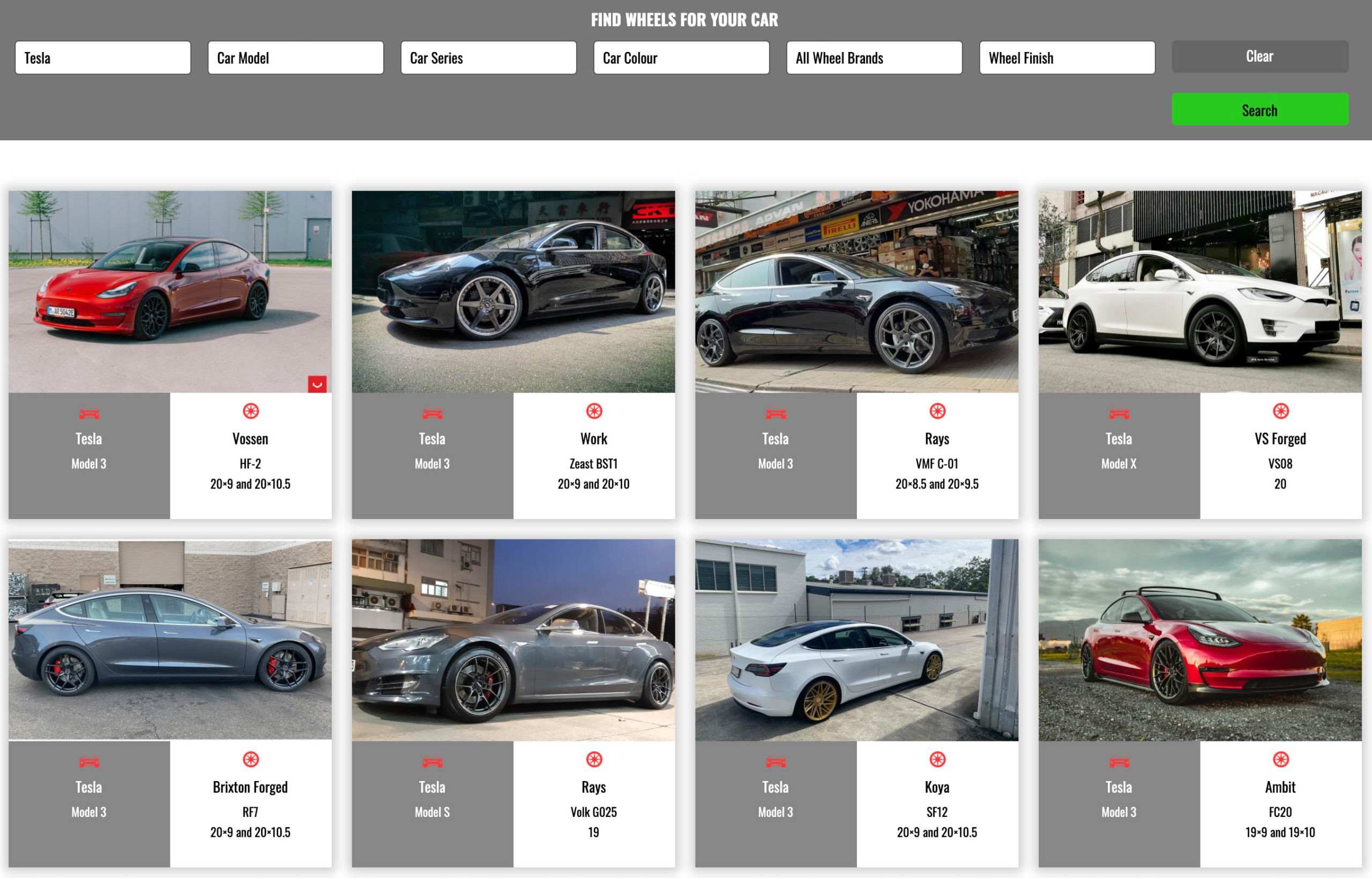

Just discovered this wheel gallery site. Lots of Stinger specific photos available, you can even filter a single car color, brand of wheel or finish.

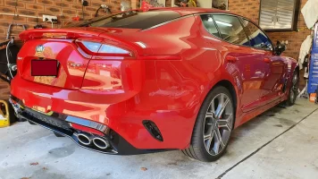

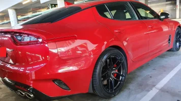

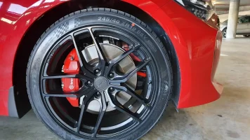

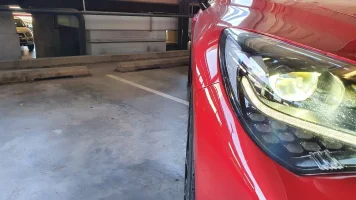

@Billy M, long overdue but here are some more pics...
