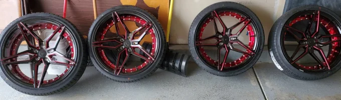

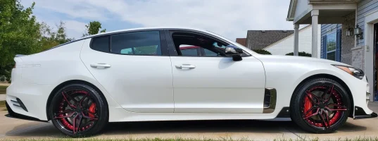

Front:
20x9+35 245/35-20 (w/ 5mm spacer)
Rear:
20x10.5+38 275/30-20
Front:
Rear:

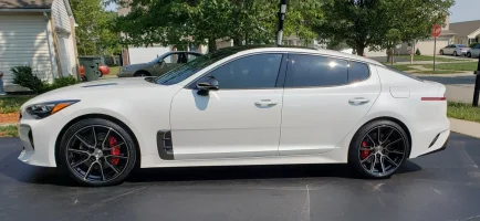

Very sharp! I had been eyeballing these while looking for my set before deciding on the Gemello. Such a tough choice, but glad to see I wouldn't have gone wrong either way. Enjoy them!
