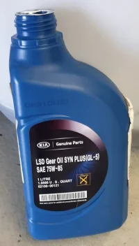

A technical service bulletin from KIA mentions the "abnormal rear differential noise of rrrrrrr" (lol) and specifies the oil be replaced with "SK HK JL Syn LSD Gear Oil 75W85 PLUS" with a part number of 02100-00121. This oil is supposed to have "friction modifiers" in it to reduce noise. The remarks are that old oil is 3.5% friction modifiers and the new oil is 7%.
Googling this part number gets you a blue bottle with a black label which has the "PLUS" (along with "GL-5" prominently on the label. But there's apparently no way to buy this oil outside of South Korea.

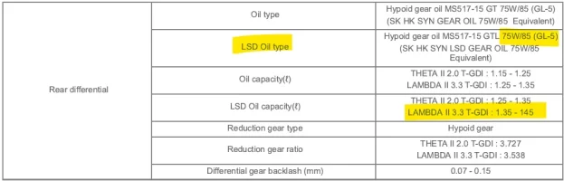

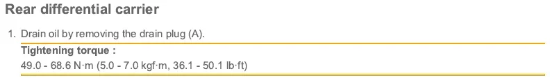

Per the KGIS service manual:
I plan on using a couple quarts of Red LIne 50104 75W85 GL-5. It seems to have good reviews, the correct viscosity, and LSD additives. I wish it came in one of those nifty Valvoline bags, but I've got a Hazard Fraught hand pump from over-filling the oil once, so all good there.
I plan on using a couple quarts of Red LIne 50104 75W85 GL-5. It seems to have good reviews, the correct viscosity, and LSD (Limited Slip Differential) additives. I wish it came in one of those nifty Valvoline bags, but I've got a Hazard Fraught hand pump from over-filling the oil once, so all good there.

Also, if you have the LSD, you're going to want the LSD Gear Oil Syn PLUS (GL-5) SAE 75W85, which is part number 02100-00121. This change is mentioned in a 2018 TSB.

Also, if you have the LSD (Limited Slip Differential), you're going to want the LSD (Limited Slip Differential) Gear Oil Syn PLUS (GL-5) SAE 75W85, which is part number 02100-00121. This change is mentioned in a 2018 TSB.

Here's the TSB info I found on a separate thread.
Take it back ASAP, this is what they should have put in it.
That's what I've been using. Redline 75w85. No complaints.
Says you should be looking for the "PLUS" oil. Both are LSD 75W85, but I believe the plus may have added friction modifiers. It seems those can be added after the fact, also. But I'm no expert if anyone wants to chime in.
Says you should be looking for the "PLUS" oil. Both are LSD (Limited Slip Differential) 75W85, but I believe the plus may have added friction modifiers. It seems those can be added after the fact, also. But I'm no expert if anyone wants to chime in.
@djerickd For reference, here is the picture of "PLUS" oil I saw over on the Genesis forum. Link to G70 forum thread.
I really can't seem to find that blue bottle for purchase, can someone link me?? That must be the new stuff because my order for the black bottles was cancelled on me. "ordered part(s) have been discontinued (no longer available) and/or is backordered with no ETA date by the manufacture"
I am preparing for the 36K mile service. :cry: They grow up so fast.
Anyone have experience or feedback with using this gear oil?
