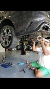

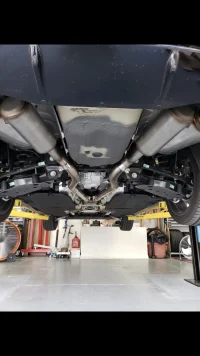

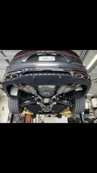

only downside is a little drone inside the car, getting aftermarket tips helps reduce the drone, aftermarket tips extends the exhaust gas to outside of the car, if no aftermarket tips, the gas gets trap under the car and cause drone.
Maybe other downside is if you park inside the garage, the cold start will be a little louder if a bedroom is next to or above the garage.

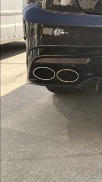

Like others have said, getting Oval 63x105 is a perfect fit, no trimming or cutting needed to the bumper. Going bigger than 105 does not increase the length, it will increase the width.
Most aftermarket tips comes with clamps that goes onto the end of the exhaust, you can increase the length of the tips by not inserting the tips all the way into the exhaust, just make sure the clamps are still able to clamp
