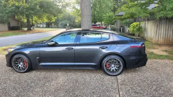

No problem, here are the photos of how the car sits with the 15mm spacers. I took them quick as I was in a rush, but you can see it basically is flush with the fenders, maybe sticking past a tiny bit. I think with 255 tires it would look a little more pokey

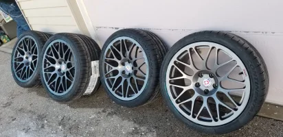

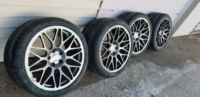

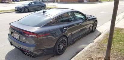

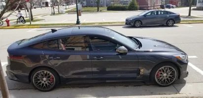

They would look better than this below, check their sizes in my sig. They are a perfect match front/rear too, but the next smaller matching-size for AWD:
Same colour car even.
Any other pictures (side/rear)?
The main takeaway is whether you like a stretched-tire look versus a more squared look.
To clarify, when I say stretched, I mean that the tread is too narrow for the width of the rim, and as a result, the sidewalls must bend inwards from the rim to meet the narrower tread.
Squared is when the sidewall goes straight-up from the rim to meet the tread.
I prefer a squared look, but unfortunately I think my current sizes are too stretched:
Originally I had 255/35 and 305/30 on the rims, but that was before I discovered that one MUST match the front/rear diameters. I thought they looked great - nice and squared:
However, to use a 305/30 for AWD, one needs a 265/35 which is too wide to fit on the front.
