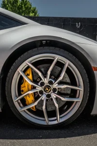

And Lamborghini stole my wheels
There is a real difference in those. Almost everything about them is different. :D Yours look better on your car than the Lambos would.
Come on, if you can’t see that one design is ripped off the other you’re blind ;)
I stole your rims too.... haha. I’ll have them mounted tomorrow. I had no idea that was a Lamborghini style, I just liked the design.

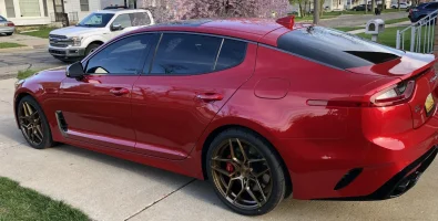

Rohana RFX11 wheels with Firehawk Indy Tires.
Front Wheels: 19x8.5 +35
Front Tires: 245/35/19
Rear Wheels: 19x9.5 +40
Rear Tires: 285/30/19
Everything fits great with zero fitment issues. I have the Ark GT-F springs coming next week. There is a ton of room to spare.
Thanks for putting the wheel fitment google sheet together guys.
Looks fantastic! Nice fit, can’t wait to see it with the springs!

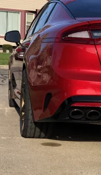

A3977717-D58D-4D29-8A6D-48452965493F.webp I forgot to post the most important picture for the forum.
