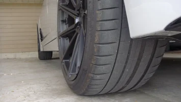

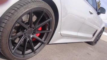

Offset is key to maintaining a flush wheel with the wheel wells. I run 8.5" wide in the front with 40 offset; and 9.5" in the rear with 39 offset, and it looks like this:

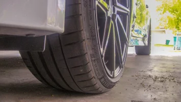

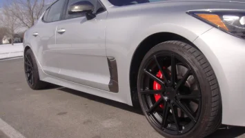

So after a lot of back and forth what I received was 19x9.5 40 offset for the rears instead of the 45 spec'd, but I figured we'd just see how it went. Good news! Poke vs. no poke is a preference thing...for me it's not something I want on mine. So I was pleased to see what I'd call fluuussshhh on the rear, slightly tucked front. I can live without the 5mm.
Final specs:
Inovit Vector in silver (they also have black) from Fitment Industries, all TPMS and lugs, etc, in the package.
19x8.5 35ET with Conti DWS06 245/35/19 front
19x9.5 40ET "" " " 285/30/19 rear
new-wheel-tire-1-jpg.35171
new-wheel-tire-front-tucked-a-bit-jpg.35172
new-wheel-tire-fluuuusssh-jpg.35173
new-wheel-tire-2-jpg.35170
