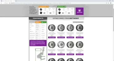

See: https://www.willtheyfit.com/index.p...ct2=35&wheel_size=18&wheel_width=8&offset2=40 for a good calculator. Shows the stretch of the 255/35 vs stock sizes.

in terms of rubber, it looks to be the same but ppl have put a doubt in my mind the 8wide from rim will not be good for the 255/35
@BlaydeX15 from the website you've provided, looks like it will work pretty well
@BlaydeX15 from the website your provided, looks like it will work pretty well

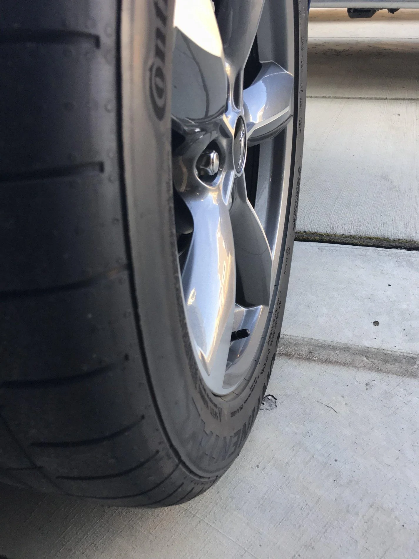

so I finally wrapped my oem rim with the Toyo Observe GSI-6
225/40/19 all around, sits as the oem tires on the front and a little bit narrow on the rear however for the winter it is what is recommended.
Waiting for actual snow to piled up on the road to test those bad boys !

That's my winter set up too, just running stock sizes
