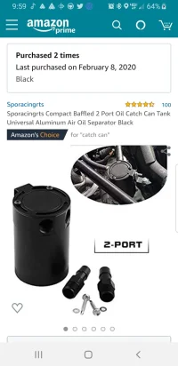

I went with two of these. The insides look the same as the high priced ones. Screenshot_20200213-095957_Amazon Shopping.webp
I went with two of these. The insides look the same as the high priced ones. View attachment 39524
Just be sure to seal up those threads on the ports. I've heard stories of fumes escaping around the threads. You'll need more than just Teflon tape to do so.
