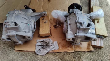

This one is actually relatively easy. I swapped out the open diff on my '19 2.0T for an LSD from a G70. It's mechanical so there are no wiring to worry about, unlike other cars with e-LSD. Well worth the upgrade.

I believe it's 53000-4J126. Between Stinger and G70, there are several assembly part numbers for the rear diff that are all LSD. The importantly part is the core 53080-47000. As long as the complete "differential carrier" contains the core, then it is an LSD, and they all have the same 3.538:1 ratio. They will have that silver label shown in my pic above - showing it's either STD or LSD.

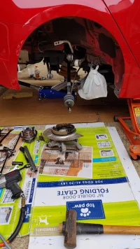

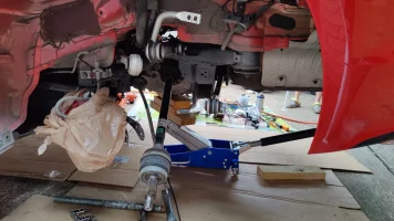

The swap is not difficult. The hardest part was removing the two half shafts from the wheel hubs. I ended up removing the wheel hubs, because I was swapping out the rear brake splash shields (leftover job from the Brembo retrofit I did). Otherwise, the hub can probably stay on the car, and you might be able to remove enough of the suspension links to swing it out of the way. Taking it out complete does make the job more open though. The shaft splines were stuck in the wheel hub awfully tight. I had to use a sledge hammer to persuade it to come out. :)
Once the shaft splines came out (as show below), the haft shaft just pulled right out. Took a good hard yank to free it, though. From that point on, it's just a straight forward R&R of the diff assembly. It's possible as 1-person job, but having a helper makes it easier and safer. We did Eibach lowering springs at the same time, so we had to take out all the suspension parts anyway. That helped a good bit.
On a scale of 1 (oil change) to 10 (engine swap), I'd rate this one at a solid 4. An experience shadetree can handle it easily as a 1-day job. Otherwise, just reserve the whole weekend on it and take your time.

The G70 6MT is the only 2.0T that came with an LSD. I know because we also have a '21 G70 6MT. The LSD on it is the same as on 3.3 G70/Stinger. They all have the exact same core p/n 53080-47000. Externally, they are also dimensionally identical. The job would be exactly the same.
