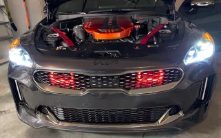

This is more of a what did you do this week to your stinger type post.
Sunday: CRC treatment
Monday: wash and clean the interior (darn you Hurricane Nicole)
Tuesday: KIA service check, aFe intake, VT snorkels w/lit kit
Wednesday: JB4 w/EWG, new MBRP active exhaust install for 22/23 models
Thursday: rerouted/wire management rethink and update using conduit
Friday: will be a rest day
Sometime this weekend: Mishi intercooler
Wife is happy the boxes are out of the dining room.
Each day after install I drove the car about 30-40 miles hard to ensure no engine codes.
CRC treatment:
I did notice a slight difference. Maybe placebo effect but it just sounded smoother. I sprayed through the throttle body. I’ve had a Mishi OCC from day 1 so it shouldn't be too bad. I’ll probably do this with each oil change.
aFe install:
Super easy. Just follow the directions and watch the install video. I had no problem with intake box bolt fitment. Yes, the 2 #32 clamps were missing from the parts. Just reuse the OEM clamp. It is ironic that there’s a quality inspection signature. I guess the same guy is inspecting all kits since so many folks are missing the #32s. I included a picture of the OEM #32 ring that’s on the turbo which you’ll need to use for installation. I had to trim both blow off valve tubes slightly. Used a well sharpened wood saw and then burned the scraggly nylon threads. Better this than the alternative. Fitment of all parts was “like a glove”.

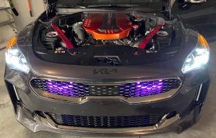

VT lit kit and snorkels:
Also very easy. No issues. Downloaded the app, connected straightaway. I was trying to use a fuse tap that is on/off with the ignition but couldn’t find one that fit our fuses. So I gave up and just wired in the switch. Maybe I’ll reattack that in the future, but for now it’s done. I trimmed the black OEM air scoop in preparation for the FMIC install, but then couldn’t figure out proper trimming to have it go around the snorkels so I shelved that part and just removed it. The MIshi IC install video has a great section on removing/reinstalling the wiring harness Which is attached to it.

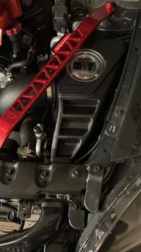

JB4 with EWG:
JB4 very easy install. Just lay it out first and think about wire management. Don’t just hook them up and not think about the routing. You can, but it will look like a box of spaghetti attacked your engine bay. There are many routes, but some are better than others. I used 1/4 and 3/8 conduit for all wires to give it a more polished look. Then zip tied them into place. I used 3M velcro style command strips to attach the JB4 and bluetooth controller. Note the small instruction on which direction to place the BT controller. Simple connect and ensured firmware update and enabled windshield wiper functionality.
EWG: I turned this into a PITA unnecessarily. My bad but live and learn. I should have installed them when I did the aFe intakes. Would have saved a lot of time. I had read somewhenre that you could reach them from the bottom fairly easy. Not on a 22!!!!! I removed the splash pan while doing the exhaust. I was able to do the driver side with much difficulty. Impossible to do the passenger from the bottom. So today I removed the passenger intake and ducting to access the waste gate. No problem. I then removed just the ducting on the drivers side (Not the intake box) and had clear access to the waste gate plug. Unplugged and reinstalled/rerouted the drivers EWG and make it more polished. Programmed proper EWG settings based on the JB4tech forums.
MBRP active exhaust for 22/23 models
Once again easy install. Since my car has so little miles the bolts came off very easily. Uninstall from rear to front. Install front to back. Leave bolts loose at first until all parts are ”hanging” from the car. then tightened from front to back. I cleaned the gaskets and then reinstalled using exhaust grease on both sides of the gaskets. The gaskets are smooth, not rippled so I wanted to remove any previous grime/grease and ensure a solid seal. I installed the exhaust as far to the rear as possible and they still only extend about 1in into the OEM chrome tips. The noise inside is noticeably louder than stock. I love the sound outside but still hoping to find a solution to increased interior noise levels. Possible solutions are clamp on a 2-3inch extension pipe and/or wait for the MBRP exhaust tips that David at K8 said are in development. Active exhaust electrical installation. It’s very straightforward and simple. Just be sure (as mentioned in the directions) the valve is open during installation.
As a side note a friend is going to powdercoat my chrome tips gloss black to match the rest of the car.
