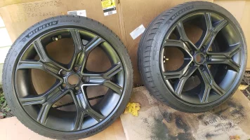

I bought an extra set of GT2 staggered wheels and tires so I could do tire rotations using four of the front wheels and tires. Had the Michelin tires dismounted from the four rear wheels so I can put a set of winter tires on them. Thinking about going with the Continental DSW06 tires but probably do 235 instead of 255 so I don't have to worry about rubbing in the front.
Today I blacked out the front wheels and did my tire rotation. Hoping I can get more use out of tires being able to do full rotations now.
