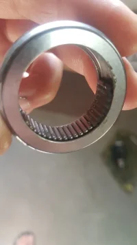

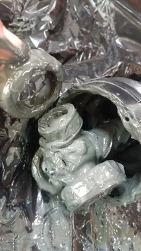

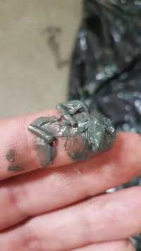

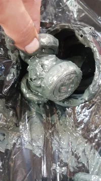

So here is why the shaft can vibrate if the cv joint pops out while installing springs or coilovers. The tip of the dog bone in the cv joint that enters the transmisstion side cup has rings with roller needle bearings. These rings tend to want to pop out if the shaft is forced down with the control arm while removing the struts. One of them slid out enough in my case to cause it to lose its rolling needles... I found them all in the grease in the boot folds. The shaft is undamaged because I ran in rwd by removing the awd fuse. I will be able to rebuild this one as a spare.
