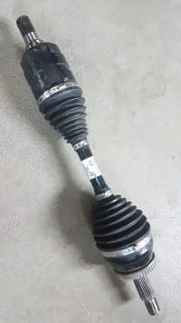

I had my passenger front shaft swapped by a good working used unit this morning. The vibration is completly gone. It set me back 545$ canadian for the part, labor and taxes. The good part is there was no core deposit, so I have my broken shaft at home. I will open the inner cv boot and see what went wrong later today, stay tuned!
