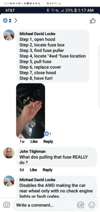

You just gotta pull a fuse to disable awd and revert the car to RWD. No check engine lights or anything. Add an LSD to the awd stinger and you got drift mode and awd!!Screenshot_20191215-223443_Chrome.webp

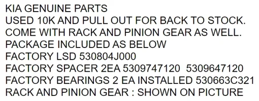

I know this thread has died and come back several times, but a 30 second Google search of the P/N (53080-4J000) came back with tons of results, all under $800 for the OEM GKN unit, which is substantially cheaper than most aftermarket LSDs. I don't post a lot, so I'm still "new" & not allowed to post links. There's also a used one on eBay for $500, including the pinion gear, spacers and bearings. Making this a lot harder than it needs to be lol. Attached is a ss from the eBay listing, showing P/N for spacers and bearings as well. Diffs are very easy to change out. No need to shell out for a full pumpkin, and would still be cheaper to have a shop install if you're not comfortable doing it yourself vs buying a full unit.

You just gotta pull a fuse to disable awd and revert the car to RWD. No check engine lights or anything. Add an LSD (Limited Slip Differential) to the awd stinger and you got drift mode and awd!!View attachment 35485
I hope you are joking. Do you know why you always tow and AWD vehicle on a full bed? Driving like this would be like having the front wheels on the ground and the rear on a tow truck.
It's not a mechanical transfer case, it's viscous, that allows the variation in torque splits.
