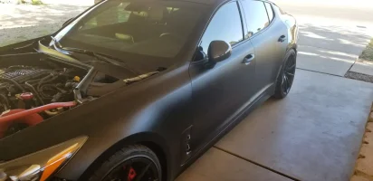

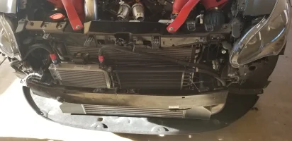

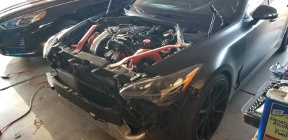

Since you asked, she's currently in pieces and getting some love
1) Complete debadge front/rear filling holes / grooves with bondo for that seamless no badge look.
2) Rewrap / ceramic coating the wrap. Never wrapped a car before, has been fun. The front bumper is terrible to wrap, and disassembling it there must be over 5lbs worth of tiny screws in that thing.
3) Carbon fiber (oem style) front /side bumper vents and added mesh screen to keep out debris
4) Carbon fiber (real) hood and decklid/spoiler
5) Fiberglass rear hatch
6) Subframe bushings
Things I've learned along the way...
1) Don't go above 50mph without the front bumper/hood/skidplate/wheel well covers you will destroy your rear skid plate (woops!)

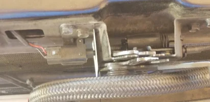

2) You can stop the annoying hood latch beeping with a cut in half plastic/business/playing card (pictured)
3) Zip ties to hold your additional coolant radiator in place since only the oil radiator came with mounts are still perfectly effective after 7500 miles.
4) If wrapping your car, use VViVid vinyl. The Avery vinyl I took off took me 12 hours with a heat gun and 2 spray bottles of goo gone gel to remove all of the leftover adhesive.
5) Nearly impossible to remove the outside door mouldings without breaking the clips off.
