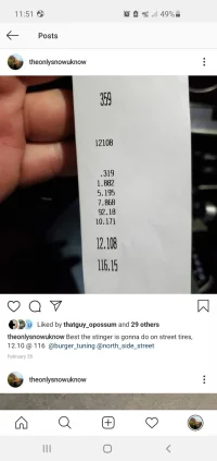

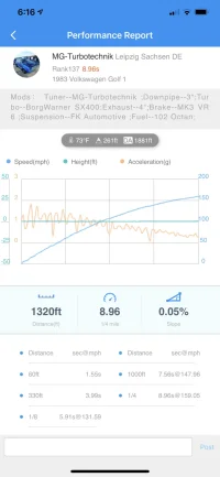

60ft is all torque and traction. I run around with a 1100hp f150 that runs 8.19 in the quarter that 60fts at 1.80s because he can't put the power down. A good long burn out and good track prep helps a lot. The hellcat next to me 60ft in the 1.40s as well. I asked when I got my timeslip if they had a problem and they said no. The 1.88 60ft was less boost off the line , that was my first launch with the brake snip.The curious thing about this is that I found a number of 8 second cars that have slower 60 foot times than you. Your car definitely seemed to hook up but I still don’t understand how a RWD 3800 pound car can get that kind of traction with normal tires like that.
It seems impossible but I definitely am all ears to find out how you did it.
Is it possible that the timing system at the track malfunctioned?
This is an example of an 8 second car doing a 1.55 second 60 foot.
Same night, just more boost on the launch. The 1.88 was the first time I had launch with the brake snip.I didn't think to look that far back. Your other run from February 28th had a 1.88 60ft and 12.10 1/4. What changes did you make between those two runs?

Any chance you could post the full slip?Same night, just more boost on the launch. The 1.88 was the first time I had launch with the brake snip.
The picture is all I have, that was done in February of this year. When I get home I can look and see if I still have it, they fade quickly.Sorry. I was actually inquiring about the other one... against the Hellcat.
