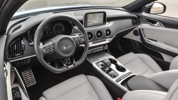

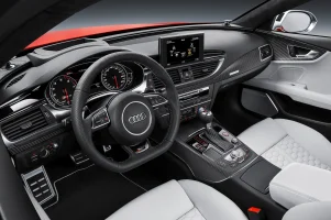

Yes its not as luxurious as a $80k+ S7 but its very close, even my friend says that and he has a 2018 S7 that looks almost the same as mine inside.
Its basically 90% the same car at half the price and since its a true GT Kia compares it to the BMW 640i GT & Porsche Panamera, both luxury GTs. Its simply the Kia name and old reputation that makes people question the "luxury" aspect. But we are quickly changing that image and people still mistake my Stinger for a Maserati & Tesla.:D
And they have almost always been discounting them just to get them on the roads for people to see. I got my GT2 way back in Feb 2018 for about $9k off after rebates $ negotiating. $41k is unheard of for a car that basically competes with S7's, 640i's & Panamera's and is surely a lot of car for the money even back then.;)
