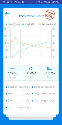

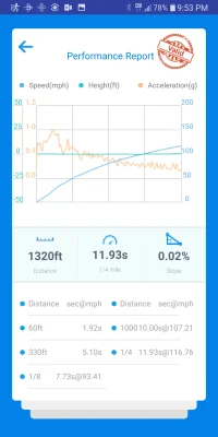

I'm back. Dragy is definitely approximate but not that bad. More later but dragy is good at Trap, terrible at 60 foot. Slope was between -.2% and -.02% Not too bad.

Dragy is very accurate. He said on Facebook: At the track one dragy was right on and the other two were about .05 slow.
It's not that accurate but pretty good on trap speed. I've also seen it a .1 fast, but not for me personally.
Dragy is accrutate if used at the track compared to to a track run at the track. Now a dragy run on winter time on a back road does not equal a track run.

I'm not sure the track method of timing is really any more accurate than dragy. But .1ths precision has always been about what to expect.

Here is dragy vs slip
My intake temps were 140 at the track and as low as 55 doing dragy runs. Thats the virtual racing magic and also why manufacturers times are hard to match.
