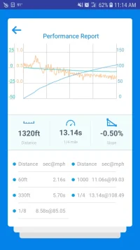

Not bad, but yeah your 60' is killing you. That's worse that most RWD Stingers and any AWD should easily be running 1.9s at least. Were you spinning the tires at launch? All seasons or Summers? Did you try the Boost-by-gear(BBG) setting in 1st and/or 2nd gears?Ran this past weekend for opening test and tune lots of breakdowns and I got there late so only got in 3 passes. Ran first time with just the JB4 set to map 5. 13.16 @ 108 mph was the best time i could put up. That best time came also at the worst time of the day for the DA 7,900'... also ran it with the draggy to see how far off it was it was fairly close in all metrics. Look how close of a run against a ECU tuned 2015 335i X drive was !
I was hoping for 12.9 in the 1/4 mile with map 5. I will try again this weekend in the morning.
How the hell do i get that 60' down ?? I cant seem to get anything less then 2.13-60' even with map 5 ????
Im running GT AWD using Launch Control. Mods: JB4 W obd cable with denso spark plugs and E30.
View attachment 23061 View attachment 23062
Maybe try DIY intakes as your giving up ~20whp with the restrictive stock airbox, especially at higher boost levels like Map5.![]()
Ive be thinking of going down the intake route anyhow this is the push needed to go in that direction.
No detectable wheel spin at launch for any run, the car is on the stock 18" bridgestone potenza all season tires. I didn't mess with boost by gear yet. Does BBG allow for more boost to help launch harder because it launches pretty soft right now no matter the map. I thought BBG would only limit psi.
Boost by gear reduces PSI by a set amount to reduce wheel spin. If you aren't having traction issues you shouldn't use it. But are you sure you're not having traction issues?
Yeah 100% sure it wasn't losing traction from wheel spin. I stuck my gopro on the side of the car pointing at the drivers side rear to check with slow motion. Took off straight as an arrow no fuss just slow.... 60'.
I'm doing AWD 1.83 60 foot on the street and track with no wheel spin so you have lots of room still.Yeah 100% sure it wasn't losing traction from wheel spin. I stuck my gopro on the side of the car pointing at the drivers side rear to check with slow motion. Took off straight as an arrow no fuss just slow.... 60'.
I just looked up what map-6 is for might try that this weekend to increase boost in first gear opposite of what RWD guys are doing see if I can find the tipping point of traction for the my awd car.
Tonkabob is already running 3.6s 0-60 times and that’s only with 2450rpm LC runs.I think what would benefit us AWD guys is a tune that takes full advantage of the AWD with an aggressive launch. Look at a car like the Audi RS3 and how it launches, and achieves a 3.6s 0-60. I'm sure our car pushing the HP/TQ that we are at tuned combined with a hard launch control would be damn quick.
I think you're failing to understand what impact elevation has on forced induction cars. A stock RWD GT at ~sea level will run a 12.9, this has been proven. At Brian B's elevation the exact same car will probably run a 13.7.I'm doing AWD 1.83 60 foot on the street and track with no wheel spin so you have lots of room still.
