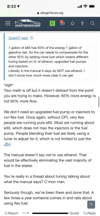

1. The manual was for sake of argument and if you look at it It literally says don't use it, so you are wrong.I didn’t say you were intentionally misleading people and I certainly didn’t label you with any insults. It’s probably just that you didn’t know or you were speaking from the perspective of being knowledgeable about a different platform and assuming the same applied to the Stinger. However, it’s responses such as yours that lead to confusion about the platform especially to newer folks.
- You said the car shouldn’t use ethanol at all and that it’s in the manual, you’re wrong.
- You said the car can’t handle an ethanol blend, you’re wrong.
- You said a piggyback can control 3 parameters, you’re wrong.
- You said the Stinger doesn’t have an available flex fuel sensor, you’re wrong.
- You said there’s not a piggyback tuning device that can tune for flex fuel, you’re wrong.
- You said that the JB4’s fuel wires are for e85, you’re wrong.
- You said 65% + 55% = 100%, you’re wrong.
2. The stock car does not have the proper gas tank fuel lines seals etc for ethanol.
3. Please name the other parameters the piggy back actually CHANGES. not just monitors. So you have yet to actually provide useful information.
4. I said a flex fuel tune, one that takes real time flex fuel % and adjusts the TUNE TABLES. I believe I said like cobb. Which the stinger does not because a piggy back is not a tune.
5. I said the only way flex fuel should be entertained is with a jb4, and I said you need roughly 35% more ethanol to compensate for the missing power that is lost. Gasoline has 114k btu where as ethanol has 70k ish.
So again, im still wating for you to provide something useful in helping OP fix his issue. I believe my original post was run pump fuel take the lap 3 off and replace the plugs and see if the misfires stop. You then started spewing bs. About the stinger being able to run ethanol. Anything car run ethanol but the car was not designed for it. So stop being useless.

- Photo is from the manual stating that ethanol can be used. Pay close attention to where the manual does not say the car cannot handle ethanol. Answers Parts 1 and 2
- Off the top of my head the JB4 can adjust boost, adjust throttle input, adjust wastegate duty cycle, and adjust AFR to name a few. With fuel wires and a flex fuel sensor connected, you open additional tuning capabilities. In addition, the JB4 will monitor ignition, timing advance, and fuel trims to trigger safety conditions and adjust the aforementioned mechanisms. Answers part 3
- A piggyback is a tuning device. Maybe you consider your RaceChip to be a static device. Some piggybacks such as the AEM FIC need to be specifically tuned to each vehicle. Once again, just because it isn’t an ECU tune doesn’t mean it’s not a tune. There are shortcomings to a piggyback and it may not be the optimal solution if other options exist, but it’s still a tune. Answers part 4
- At no point did you say anything about 35%. You said 65% and 55%. Now you want to course correct with 35%.

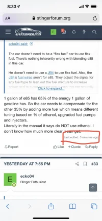

It's on a phone keypad you need to chill lolLMMFAO!!!
Now I know you’re trolling. You just edited your message from yesterday, 5 minutes ago to correct your math? C’mon man.
Here’s your original, the one that’s quoted.
It’s ok to misspeak.
