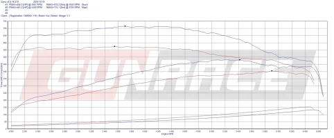

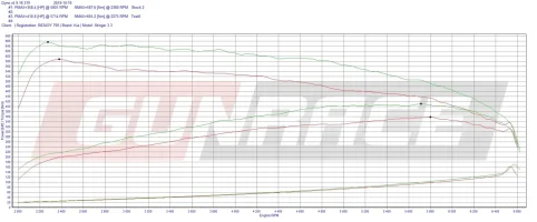

Very strange numbers. I tested stingers on various dynos and on the flywheel stock stinger shows on 95 ron 331hp, with 100 octane fuel it shows 358hp, with full bolt ons + big intercooler it shows on 100 octane 376-404hp (different cars, stock ecu, same mods) with stock tune untouched.
With lap3protuner it shows maximum on 100 octane fuel 480hp (flywheel) and wmi 505-510 hp.
Stock 95 octane
Thats stock car 100% 358hp on 100 octane.
Big Intercooler, no air filters, no catalysts, custom exhaust straight through, 100 octane, maxed out turbos on Lap3pro v2 (can't get any more boost from them), maxed out ignition.
Those numbers are at flywheel. They are similar at 3 different dynos Superflow, Maha and V-tech dyno. Usualy Dynojet shows XX% higher output at the wheel horsepower then Superflow / Mustang dynos. So 490 dynojet who is approximately 440 mustang who or 500-510 hp

No offense but your results are slightly low for both stock and tuned. Maybe Moscow Stingers got different ECU tuning but dozens of stock Stinger dynos in the USA show 320-340whp(380-400bhp) & 380-395wtq.
A JB4 Stinger with only intakes on 91octane made 417whp/515wtq, then 93octane+e30 made 441whp/518wtq and lastly 462whp/531wtq with WMI.
I personally know multiple JB4 Stingers that gained around 120whp/120wtq and run about 450whp/500wtq with just a few bolt-on mods. And a couple lap3 WMI Stingers that make around 480whp/530wtq. Lastly, one of the quickest WMI Stingers(11.5sec 1/4m) produced 442whp/525wtq on a Mustang dyno or about 490whp on a dynojet, and he had a JB4 with completely stock exhaust and no intercooler.
Those results are very common here, but I do agree that dynojets typically run about 10% higher than Mustang or load based dynos. Load based dynos may be more realistic, but the load can be adjusted on each dyno so dynojets are more consistent, especially for comparisons. I know different dynos with different conditions may vary significantly, but dynojets are much more widely used and is the “rule of thumb” dyno in the states.
In the end these numbers arent much different than yours and likely the extra 20-30whp is because this was a “kill mode” custom map with TDC ignition timing spoofing that added a few degrees timing advance on the first run before it was pulled on the second run.
