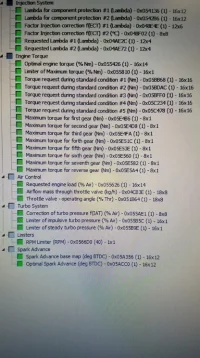

It caught my attention too until it became apparent its just generic mapping from a tuning software. Its also missing a bunch of important maps that Tork posted in his pictures.
The blacked out pictures was useless as Tork just posted the clear picture of the Map definitions.

Look at the title on the definition that I posted
I see it. Is this not just the generic mapping you can buy from titanium that a Tork and KLR mentioned?
No sir. If it was the generic you mention then Tork would be the same or more developed, correct?
So the picture you posted isnt the same one that Tork posted of what he pulled from titanium? They look simular.
Index you posted:
6ca820ab-f831-4737-92ba-9d5d7fad545c-jpeg.18328
Index Tork pulled from titanium and posted:
The one CD posted and the one torq posted are indeed different. The black out is the address and scalar of the map table. That's the secret sauce. would be great if they collaborated and made the most of each others work in my opinion.
Got ya. They looked the same to me just different placements of the index. Thanks for clearing it up.

I see it. Is this not just the generic mapping you can buy from titanium that Tork and KLR mentioned?
That's all any flash tuner buys, a definition file with table addresses and poorly translated descriptions for the ROM version. Then the tuner changes the values in the tables to perform the tuning. It's really not rocket science to those who are in the industry. There is a trend among "some" flash tuners to make the process seem more complicated and involved than it is so they can charge more for their services and/or impress their customers. :)

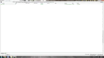

This is the non turbo 3.3 GDI map index, 23,000 + maps (attached image). I have heard rumors that the DAMOS for the 3.3TT version is pushing close to 60k maps.
Now, a properly translated and description index with notes, costs a lot of money, I own about a dozen of them for the different markets that we tune in. I am laughing at the "rocket science" comment, because... if it were so easy, you would already have a BEF and wouldn't have to steal other company's hard work (like I have posted about many times now).
Look at the move LAP3 just made with their tune, moving away from a piggy back... and made considerably more power. If ECU tuning were so easy as you make it out to be... curious why you don't develop your own BEF to compliment the JB4 in all the markets you support?
20,000 tables. lol right. There are a few hundred relevant tables and only maybe 30 of those you need to change for tuning. Load target, base ignition, base lambda target, a handful of modifiers, and a handful of limiter tables you need to raise the values on. It's really not rocket science.

Do you think I am lying Terry? I agree, there are a few 100 relevant tables, there are considerably more than 30 maps we are changing. Last time I checked, we were making 96 ignition map changes to our Stage 2 Beta tune... that is just ignition. What do you do about the x and y axis tables that limit RPM, load, boost, timing, temp, ect? What do you do about transfer file index and priority limits? Torque, Air Mass, Turbo Speeds, Turbo Safety Limits, ect? We have not even got into turning off codes for decat, or removing OSC limits for oxygen storage limits for cat pre-heat.
Now, lets not even talk about the mean cylinder pressure limits, acceleration limits, vehicle mass, flywheel mass, top speed, RPM limits (soft, hard, stationary, park/neutral, coolant temp, oil temp, ect) and everything that goes into making a "proper tune".
A buddy of mine tunes the R8, RS7 and a few of the other higher end Audi's... to change idle parameters for the V10 inside the new Audi ECU, 400 maps needed to be changed.
