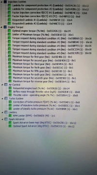

View attachment 18328 I guess is what you know and who you know and pick the right tuning tool. What do I know, I’ve only been tuning for 20 years. Oh, and we can tune the TCU also. Getting closer, see y’all soon :)

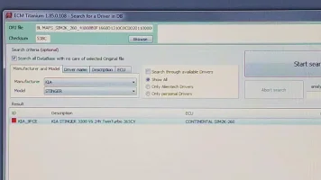

Looks like ECM Titanium from Alientech. Is this a custom driver config or available in there databank? IE can any Alientech databank subscriber access the maps defined thus far?

If he would like to uncover the black portion of the picture we can go through and confirm map definition we can confirm it is all correct for you, for some reason I highly doubt they gave you the wrong definition.

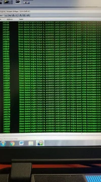

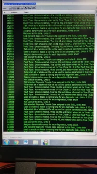

This is what full file definition looks like.

So this is the same tool you've been using to tune?

Looks like there are a few on the other driver definitions that are missing in this one. The torque at launch condition for example. Is that in your definitions too JB?
Do you mean stationary break torque? Or Launch Control Torque?
