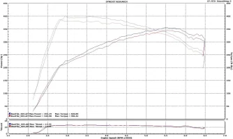

We have also been tinkering with our new shop Stinger here is a dyno chart of before and after muffler deletes.
