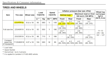

Quick question: what cold pressure are you running with on your squared 225/45R18's?

The reason I was asking was also as a result of the information I found on the tirerack website where they suggest running pressure anywhere from 2 to 5 psi higher than summer.
I was wondering what members of this forum think about this logic?
