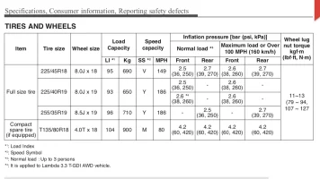

Those pressures are for the 18" rims.

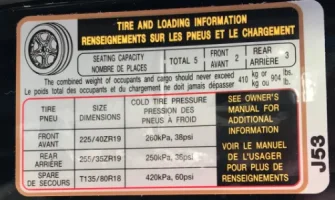

My original post in this thread referred to what I found on my door jam.
In my case, that is for the 18" A/S tire option. Whatever combo people have, the door jam numbers are your reference.
It is what it is ...
Check you door jam.
I don't have a Stinger with 19" wheels. It will have 19" wheels on it when it arrives, but I am seriously considering going back to 18" wheels for a variety of reasons - cheaper tyres, taller sidewalls providing slightly better ride and avoidance of pot-hole damage (Sydney roads are crap).
I was wondering if Kia was advising a different pressure based on the comment from Silverghost that the pressures in that diagram are for 18" wheels. I'd be a little surprised if they do, 18" and 19" wheels really aren't that different.

That's quite interesting. Quite a lot of variation across the various variants.

19" rims are staggered, 18" are not. Also, different tires as well.

My Gt (2) premium placard reads 36 front 38 rear.
