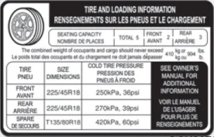

It's important to keep in mind that the car placard tire pressure is as if the car is always carrying its full payload.
That being said, there is certainly room to reduce pressure in accordance to the actual regular vehicle weight.
Had my Stinger GT a week now, noticed when I bought it that the tire pressure read out on the dash showed 59 psi all the way around.
Thought it was some kind of special tire (low rolling resistance?) but decided to now check it out.
Yikes! Door jamb sticker says it should be 36F/39R, adjustments made. Is this how some cars are being delivered?

It's actually how they all come to the dealer.
Dealers should be fixing this as part of their pre-delivery work. If they're not, one wonders what we're paying them for...

My tyres read 50psi on delivery, only found a few days later. I was told when I inquired that they leave the factory with 50psi for the boat trip and then a possible wait in a holding yard. They expect to lose a few lbs before purchase. Clearly not.

Incomplete dealer prep.
Low profile wheels need higher pressure to keep from bending wheels on potholes.
Higher pressure in the rear will make the car more twitchy (oversteer)
Lower pressure in the rear will make it more stable on the highway (understeer)
Higher pressure makes the ride harder in general.
It is what it is ...
