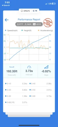

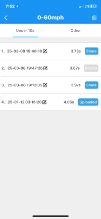

Pretty neat. Intake temps 8-12f about ambient
