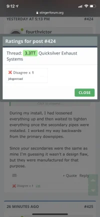

During my install, I had loosened everything up and then waited to tighten everything once the secondary pipes were installed. I worked my way backwards from the primary downpipes.
Since your secondaries were the same as mine I’m guessing it wasn’t a design flaw, but they were manufactured for that purpose.
@jdogonroad Do you care to explain why you disagree? I was simply stating what I did during my install.
Haven’t a clue what you are talking about. Went back searching this thread several times, and can’t find anything you could possibly be referring to.
Maybe it was on accident?
Post #424, you clicked the disagree button.
Have no earthly idea why I would have done that. Thought it was brilliant, actually, and good advice. All I can say is that I may have had a fat finger/old eyes moment.
No worries. Happens to the best of us.
