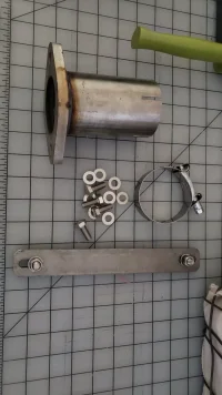

We're you guys able to re-use some screws and nuts? Just curious what hardware was received with your exhaust. I have the cross brace, 2 bolts and nuts for that with washers, and 4 bolts with 8 washers. Also a sleeve with a clamp for the one side.

This is what I got... Sounds like you're good to go.

THANK YOU!
