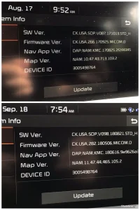

    This is a weird one to me, it must be a hardware issue and not a software issue otherwise I cannot understand why they would replace the whole head unit. Clearly the software can be updated without doing that. My car was built in 12/17 but I have never experienced this issue. But because it was built so early I just asked them to send me an updated maps free of charge to get to the current version when purchased. They delayed sending me the map update by a couple weeks because another new update was coming out and I just received it yesterday and performed the update. Here is a screenshot of my versions before and after the update. All of the software versions are newer now,not just the map version.

    If whole unit replaced, why Device ID is the same? Strange...

    He did not replace the head unit. Just did the software update. He said his did not have the issue.

    That's correct, I was just posting that I don't understand why they are replacing head units when it appears the SD card map update can update all the software on the head unit. It would be interesting if someone that had this problem updated their maps to the latest release and see if it fixed the problem or not without having to swap out the head unit.
