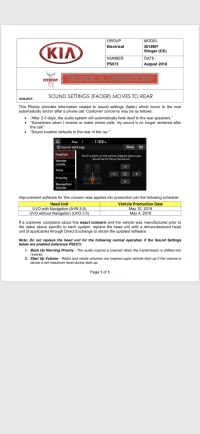

I just came back form picking up my Stinger from the dealer after they performed the PS573 (this is the official pit stop bulletin released by KIA to address the issue), which involves a head unit replacement to fix the issue with the fader moving to rear speakers randomly. No software update for the infotainment system without replacing the whole head unit.
I would also like to thank my service adviser, Sebastian Flores, who was very accommodating during this process, he even took some photos of the install so I can post it here for you guys. Also thanks to Rick Hall (sales manager at Westside Kia) for making the process a breeze and providing a loaner vehicle (Sorento).
The head unit replacement takes a few hours perform, so you will definitely need to drop it off and pick it up later that day or the following one.
Here you can see the that the replacement unit is a brand new unit and not a refurbished one. It also came with an updated navigation map sd card
Here are few photos, courtesy of service adviser, Sebastian Flores at Westside Kia.
Here you can see that almost the whole front of the dash has to be removed in order to gain access to the head unit.
On these next two photos you can see the new head unit being installed
A bonus that I was not expecting is that the new head unit came with an updated Nav map SD card.
NOTE: I had not updated my NAV via the courtesy update offered by Kia. I had the version that came with the car when I first bought it.
Previous version
New version after head unit swap

Man it sucks that they had to do that much disassembly to fix it.
They may have significantly increased your chance of experiencing some creaks and rattles.
Previous version
Honestly, if it is a one time thing I don't think it will increase it at all. Also keep in mind that these plastic are still brand new therefore they are still flexible. We are not dealing with 5 or 10 year old plastics.
