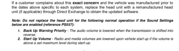

I just had my dealer tell me that they think based on the above section of the TSB that because I have Back Up Warning Priority and Start Up Volume turned on that they shouldn’t replace my radio.
I tried explaining to them thats not what that means but they weren’t having it.
That doesnt make sense. If your fader is going to the rear and you are not in reverse or already in drive, it should not lower the sound. Mine happens when I use my bluetooth in drive position and it fades on me. I would call customer relations.
Yeah I tried to explain to them that it meant don’t replace the radio if the customer complains about those things happening and has the features enabled but he thought he was smarter than me so he didn’t want to listen. I called Premium Customer Service but Tech Line is the one that has to tell them they are wrong so I’m waiting for them to call the dealer.
Even if you had them enabled, once you switch to drive it should revert the sound back to normal.
Also if you complain that it's doing that when you either first start the car or in reverse, it makes sense and for those reason, they would not need to change your radio because it is working as intended. Let us know what they say. I have my appointment tomorrow for the same thing. I will turn those off and demo it to the technician.
Not 100% sure, but I think I remember I that this issue of the fader moving to the rear is triggered by a phone call with bluetooth. Now, if you go to the dealer with Back Up Warning Priority and Start Up Volume turned off and you can replicate issue by a phone call in front of them, I do believe they must accept it and replace the unit. You just have to give it try and find out if what I said is true or BS.

Dealer called back and got the go ahead from KIA, I got a “no comment” when I asked them to confirm they read it wrong and I was right.
Nice! So do you have to leave the car with them, or do you have to come back when the part arrives?
They already had the part which was what was extra frustrating. They read the TSB and ordered the part, then when it came in said they shouldn’t have.
I go back friday to have it installed.
