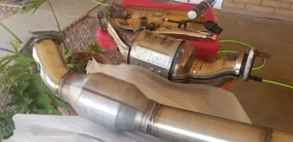

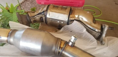

I have the Ultimate Performance cats / pipes. Still get CEL on the LH cat with the spacer and not really enough room for another spacer. No overboost and they sound really good (LOUD, so be prepared) with the Borla S catback. Like them better than SSR DP's but I would recommend wrapping the pipes at least down to the cat portion since they do radiate more heat into the engine bay than stock as they do not have the heat shields.

I have the Ultimate Performance cats / pipes. Still get CEL on the LH cat with the spacer and not really enough room for another spacer. No overboost (map8, WMI, with customizations) and they sound really good (LOUD, so be prepared) with the Borla S catback. I like them better than SSR DP's but I would recommend wrapping the pipes at least down to the cat portion since they do radiate more heat into the engine bay than stock as they do not have the heat shields.

Your spacers are too short.
I 100% agree and will try it out with a longer spacer (defouler) when I wrap them in titanium wrap this weekend to see if that helps my iats since all of the heat is ending up in my engine bay. For saving the environment purposes, of course, maybe not ideal for some certain off track emissions testing. The problem now being since there's hardly any room for that secondary O2 sensor as it is, I'm now going to have to touch the wire to the tranny. Oh well, will wrap some cold tape around the whole thing and hope for the best until the tranny inevitably blows and deal with it then. Will let ya'll know if the CELs go away with the longer spacer on the LH secondary O2 sensor.

After adding a longer spacer (spark defouler) to the LH secondary O2 sensor, I'm no longer getting the P0000 CEL with the Ultimate Performance DP's. Didn't add a spacer to the RH O2 sensor since that side wasn't throwing a code, and it still isn't. My primary LH O2 sensor had half of its face shaved off when that turbo blew and Kia didn't bother replacing it, so perhaps that side was just out of calibration enough to throw the code. At $230 for a primary O2 sensor or having to deal with the service department again for a free replacement, I opted to just leave it.
IAT's dropped 10 degrees avg wrapping the downpipes in titanium wrap and the charge pipe down to the intercooler in cold tape (fiberglass), so a win there as well!
