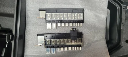

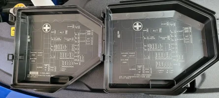

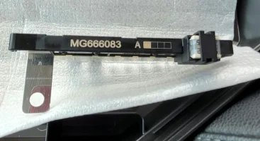

Kia dealer called today and said that the parts for this recall came in. Dealer said that part number has changed to 91KIT-J5USAQQK.
I picked up the parts and I was surprised. You now get a new fuse box cover with the 25A markings for the ESC fuses. You also get a new multi fuse with replaceable 25A fuses.
So it looks like all you have to do is replace the multi fuse and you're done. No fuse box removal, cutting or splicing.
This new method should have been done in the beginning. The parts are cheaper than paying the dealers to cut up the old fuses.
I paid $5 for all of these parts.
These new parts make this recall an extremely easy one to do it yourself.

Changed the multi fuse tonight. Car drove fine afterwards.
