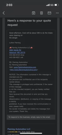

Got a price quote for walnut blasting not bad but I’ll still shop around
$500 is still not bad, especially if they do an excellent job.
