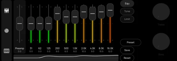

As far as noticing it, I'm talking about putting my hand on the sub, and feeling like there's stronger vibrations coming from the door..
none of that music you listed above will hit low enough to get the factory subs moving. i listen to thrash / metal / rock, and same deal - the factory subs are crossed over at an extremely low frequency (around 40Hz), which means frequencies slightly above that are all filtered out. 40Hz is getting into the subsonic frequency range, where you don't even hear the sound, you *feel* it
two solutions -
(1) add a powered sub, or amp and sub. my powered sub is crossed over around 100-ish Hz
(2)use an EQ to boost the lower frequencies. i use the Poweramp app to listen to music on AA, and give a slight boost to 62Hz - you can hear the underseat subs more. ((not my settings below, just a pic from the internets))
if the new software update does "make the factory subs more noticeable", i'm sure all they did was raise the value of the lowpass filter up from the 40-ish Hz it had been set at

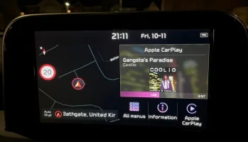

Updated mine today. The new colour scheme at night is pretty cool :)
two solutions -
So, I tried this - using powerAmp and a tone generator. I played around with the tone generator from 40 Hz down to 10 Hz (just briefly) and got pretty strong sounds / vibrations at every frequency. I thought I set powerAmp back to default, but after doing the tone generator, I find I had WAY more bass than before. To the point that I had to adjust the "tone setting" in the car and lower the bass boost (I had it at +2 or +3, backed it off to +1 or 0) because I was getting SO MUCH bass.
I'm pretty sure I didn't quite reset powerAmp properly, because it seems to be from phone playback, not as much with radio. So yeah, I definitely got response below 40 Hz.
