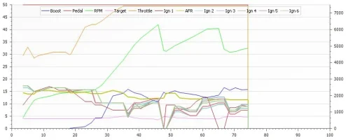

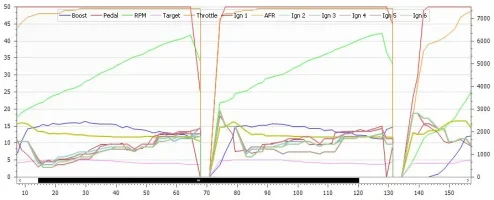

New JB4 Stinger Dyno Results!
Runs are not apples to apples but just looking at these two logs the 91 looks no worse and maybe a little better than the 94.
